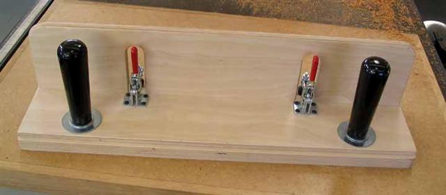

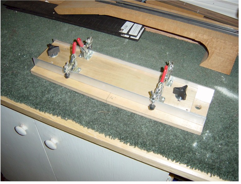

I'm making a brace profiling jig, similar to the above. Has anyone made one like this?
Someone used to sell plans for this on ebay. I made a couple versions and prototypes.
I like the safety guard, but you have to bend over it to see what you're doing. (Adding more risk)
Improvements I plan to make are:
replace safety guard with plexiglass
add a third toggle clamp (to reduce vibrations and blowout on the ends)
Any input? Any pictures? Any plans?

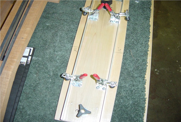

PostPosted: Wed Oct 25, 2006 12:10 pm
I have one. It is double sided. 16' on one side, 28' on the other. No guard.
It is very simple.

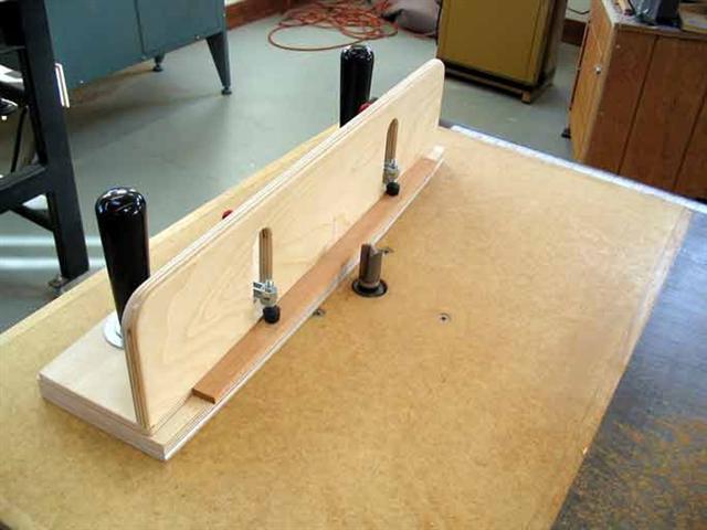

Here is mine, rough cut on the bandsaw, then sand to shape on your dish. I use a bottom bearing bit(it's a top mount actually as the bit is upside down in a router table). I agree with three clamps, especially for the x-brace.

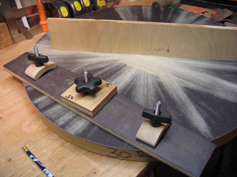

Posts: 147
Terry, This is the jig I use for my braces on the router table.

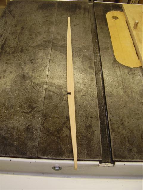

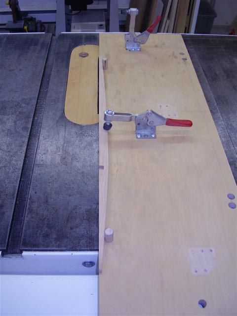

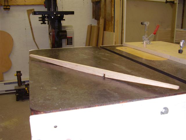

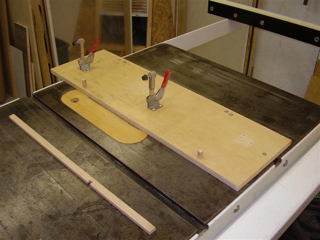

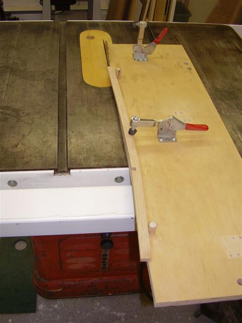

First off, Sorry Terry, I know this was about the router shaping jigs, but I thought I would share mine. It could be used with a router too mind you, just run the board past the flush cut bit.
I made a simple cutting board for the table saw (Bet it's faster than your hand plan Mario ) only difference is the possible danger factor. No blowouts, and if you use that great saw blade of yours, I bet your good to glue after the cut. (BG)
I also use this same board for my fretboard tapering, just pull the dowels and use the same hold down clamps.
I posted this several months ago for Serge. This was a test cut for the picture perpose (didn't use the brace)

A while back I made a jig similar to what Rod shows and I really like it, mine has more clamps. I make the cut on the table saw and then swipe it with a hand plane before removing it from the jig. No tear out problems like I used to get with the router. and I have a planed surface for joining.

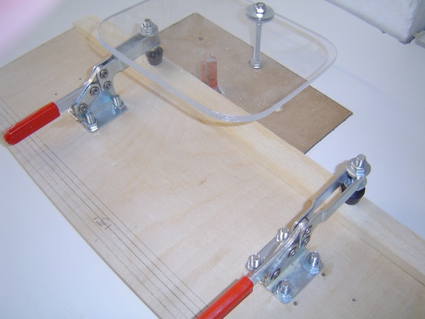

As with all my jigs I try to keep them as simple as possible. I only build four or five guitars a year so my brace shaping jig is only going to get about an hour use a year. It's used with the router and I usually give two passes the first just a light touch to take the corners down and then run it across with the bearing against the template. To cut the back taper I just unbolt the clamps (simple technology again) and refit the the other way.
